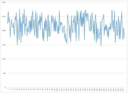

I have a 250-time points series of actual data and I want to generate a similar time series including all its curves
first, I was interested to know its probability distribution and see if it fits other distributions, after fitting, it was Normal and Lognormal seem better. So I generated 250 points of Lognormal but they came absolutely random resembling no properties of the original time series (Lognormal are illustrated in the second chart)
The original time series it looks like this
My generated Lognormal according to the data parameters looks like this

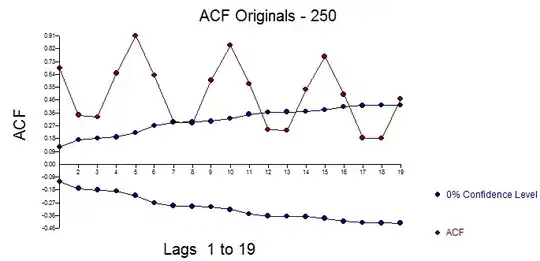

Here is the ACF of the origenter image description hereinal series . AUTOBOX rendered a model here enter image description here with residuals here enter image description here and acf here enter image description here

I show here the acf of the original 250 values enter image description here and the acf of the first replication of the 250 simulated values enter image description here . The simulated series "resembles" the original series which is what I think you want to do.
