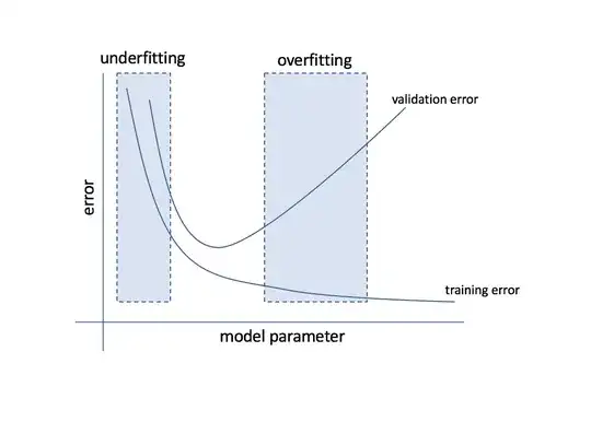

If number of epochs is another parameter you want to tune (i.e., want to test 50, 100, 200, etc..), then simply introduce it into your parameter grid search and select the best $n^*$ from your grid search. The one thing to be careful with training a model too long (specially with optimization schemes like gradient descent) is that eventually they'll start to overfit, so check the training and validation error with plots like the below. You basically train until your validation error stops improving (not the training error).
Here's the link to where I got that image (https://www.jeremyjordan.me/evaluating-a-machine-learning-model/). This person has a great tutorial on model evaluation.

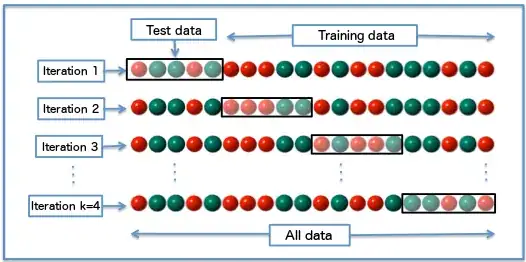

but the principal cross-valididation works like this: enter image description here
so basically during every training and test split you will have different parts of the data. This is usefull to test if you are overfitting (biased) or underfitting your algorithm by get a specific training part of your data.
So you can also split your data step by step, when you do not have enough memory error and train and test it with the same algorithm, this is the same as running it in one run.
