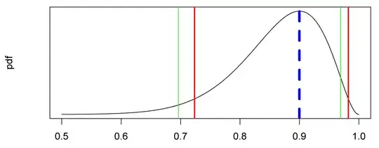

Having learnt the principle from BruceET's answer, I have created another version that avoids simulation. Instead I use dbinom() to calculate the probabilty of getting the observed result over a regularly spaced array of p values. These values yield an unscaled discrete-valued pdf, which is integrated to create a cdf, and then linear interpolation is used to generate a continuous inverse cdf. I report the confidence limits such that the area in each tail is equal (green lines). But I then search systematically across values of the area in the left tail of the distribution (from 0 to alpha), finding the value that minimises the width of the 1-alpha confidence interval; the resulting confidence limits (red lines) are more satisfactory.
> f <- 18 ; n <- 20 # observed f successes out of n trials
> alpha <- 0.05
> m = 10^5
> p=seq(0.5,1.0,1/m) # uniform prior
> pdf=dbinom(f,n,p) # not rescaled
> cdf=cumsum(pdf)  # "integration"
> cdf=cdf/cdf[1+m/2] # so now runs to 1
> invcdf <- approxfun(cdf,p) # function relies on linear interpolation
> scl = c(invcdf(alpha/2),invcdf(1-alpha/2)); scl # CLs with equal area in each tail
[1] 0.6964185 0.9695073
>  mm = 10^5  # this section minimises width of CI
>  lt = seq(0,alpha,1/mm)  # area in left tail (0 to alpha in steps of 1/m)
>  i = which.min(invcdf(1-alpha+lt)-invcdf(lt))
>  i/(mm*alpha)  # ~0 => 1-tailed; ~0.5 => symmetric
[1] 0.8854
>  cl = c(invcdf(lt[i]),invcdf(1-alpha+lt[i])); cl # CLs minimising width of CI
[1] 0.7235043 0.9823723
> plot(p,pdf,type="l", yaxt="n")
> abline(v=max(0.5,f/n),col="blue",lwd=4,lty=2) # observed
> abline(v=scl, col="green", lwd=1)
> abline(v=cl, col="red", lwd=2)
pdf with limits
