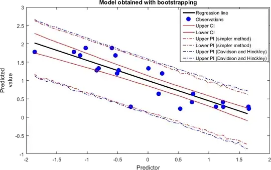

On the same topic: after trying the method described here: Bootstrap prediction interval and the one, simpler, described in the YouTube video linked above, on 1000 bootstrap replications, I obtain the Prediction Intervals shown in the figure.
They are pretty similar, though the method from Davidson and Hinckley seems to return slightly broader PI. What is the benefit of using the first method over the second? Can it be that with a bigger sample size (I have only 22 observations), the difference between the two Prediction Intervals would increase?
