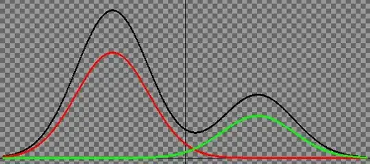

EDIT: The setting of my actual application is too complicated to describe it here. So, I'll give a toy example: Let $f_{\mu,\:\sigma^2}$ and $\Phi_{\mu,\:\sigma^2}$ denote the density and cumulative distribution function of $\mathcal N_{\mu,\:\sigma^2}$. Take $k=2$, $\mu_i\in\mathbb R$, $\sigma_i,\varsigma_i>0$, $$p:=c_1f_{\mu_1,\:\sigma_1^2}+(1-c_1)f_{\mu_2,\:\sigma_2^2}$$ for some $c\in(0,1)$, $q_i:=f_{\mu_i,\:\varsigma_i^2}$ and let $\varphi_i$ be the quantile function $\Phi_{\mu_i,\:\varsigma_i^2}^{-1}$.
Here's a examp with $\mu_1=-2$, $\mu_2=2$, $\sigma_1=\sigma_2=1$, $\varsigma_1=2$ and $\varsigma_2=5$:
$p$ is the black, $q_1$ is the red and $q_2$ is the green function. Here we could take, for example, to take $w_1=1_{(-\infty,\:0)}$ and $w_2=1_{[0,\:\infty)}$.

    "...prefers to move to states where $q_i$ is a good approximation of $p$" does not imply that the resulting random numbers have anywhere near the true target distribution. It is not at all clear to me that this is a workable approach, except perhaps in special cases... please correct me if I've misunderstood something! – jbowman Aug 02 '19 at 16:18
  • @jbowman In the application I've got in mind, samples from each $q_i\lambda$ are locally quite well distributed, but not everywhere. – 0xbadf00d Aug 02 '19 at 17:55
    What example do you have in mind? Some extra context might be useful. – πr8 Aug 02 '19 at 20:01
  • @πr8 My real application is too complicated, but I've added a toy example. – 0xbadf00d Aug 03 '19 at 09:28
