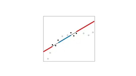

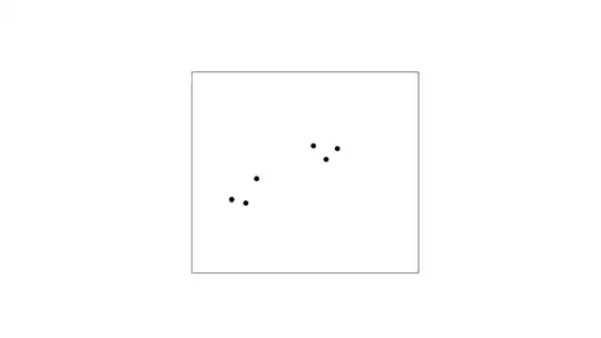

To add a visual explanation to this: let's consider a few points that you plan to model.
They look like they could be described well with a straight line, so you fit a linear regression to them:
This regression line lets you both interpolate (generate expected values in between your data points) and extrapolate (generate expected values outside the range of your data points). I've highlighted the extrapolation in red and the biggest region of interpolation in blue. To be clear, even the tiny regions between the points are interpolated, but I'm only highlighting the big one here.
Why is extrapolation generally more of a concern? Because you're usually much less certain about the shape of the relationship outside the range of your data. Consider what might happen when you collect a few more data points (hollow circles):
It turns out that the relationship was not captured well with your hypothesized relationship after all. The predictions in the extrapolated region are way off. Even if you had guessed the precise function that describes this nonlinear relationship correctly, your data did not extend over enough of a range for you to capture the nonlinearity well, so you may still have been pretty far off. Note that this is a problem not just for linear regression, but for any relationship at all - this is why extrapolation is considered dangerous.
Predictions in the interpolated region are also incorrect because of the lack of nonlinearity in the fit, but their prediction error is much lower. There's no guarantee that you won't have an unexpected relationship in between your points (i.e. the region of interpolation), but it's generally less likely.
I will add that extrapolation is not always a terrible idea - if you extrapolate a tiny bit outside the range of your data, you're probably not going to be very wrong (though it is possible!). Ancients who had no good scientific model of the world would not have been far wrong if they forecast that the sun would rise again the next day and the day after that (though one day far into the future, even this will fail).
And sometimes, extrapolation can even be informative - for example, simple short-term extrapolations of the exponential increase in atmospheric CO$_2$ have been reasonably accurate over the past few decades. If you were a student who didn't have scientific expertise but wanted a rough, short-term forecast, this would have given you fairly reasonable results. But the farther away from your data you extrapolate, the more likely your prediction is likely to fail, and fail disastrously, as described very nicely in this great thread: What is wrong with extrapolation? (thanks to @J.M.isnotastatistician for reminding me of that).
Edit based on comments: whether interpolating or extrapolating, it's always best to have some theory to ground expectations. If theory-free modelling must be done, the risk from interpolation is usually less than that from extrapolation. That said, as the gap between data points increases in magnitude, interpolation also becomes more and more fraught with risk.

    I like your answer, and regard it as complementary to mine and in no sense competing. But a small point, important for some readers, is that red and green are hard for quite a few people to distinguish visually. – Nick Cox Jul 24 '19 at 10:27
    @NickCox Good point, thank you for raising that - I've now changed the colour scheme. – mkt Jul 24 '19 at 11:06
  • I don't like this answer very much. The fact that your example data is just two blobs means (or at least it could mean; it's hard to be confident with only six sample points) that interpolating between them could also be considered extrapolating outside of the data support. And it would be quite conceivable for the extra data points to diverge strongly in that region. There might actually be a better quadratic model. If you're going to interpolate in such a situation, you'd better had an a-priori reason for preferring a particular model. And that is also the case for your CO₂ example! – leftaroundabout Jul 24 '19 at 14:28
  • @leftaroundabout The fact that the true shape is ambiguous in the example is intentional. But would it matter a great deal for the argument if the gap between the point groups was narrower? As I mention in the answer itself, interpolation can go wrong too - you're just less likely to encounter large changes in shape there. Regarding your claim that "interpolating between them could also be considered extrapolating outside of the data support", I think that is simply incorrect. The data range encompasses all the points, and no amount of clustering alters that. – mkt Jul 24 '19 at 14:59
  • @leftaroundabout I completely agree that there might be a better model for the data points I present - that was the point of the final figure. But even with a poor model, the interpolation performs better than extrapolation, which is not an uncommon occurrence, though not universal (which I note in the answer). – mkt Jul 24 '19 at 15:02
  • @leftaroundabout I don't understand your point about interpolation as it pertains to the CO2 example, since those measurements are so frequent that interpolation is uncontroversial: https://www.biointeractive.org/sites/default/files/styles/feature_image/public/Biointeractive/IOTW/keeling-onpg.jpg?itok=RIQUP1a8 – mkt Jul 24 '19 at 15:04
  • @mkt IMO it would matter if the gap were narrower. Namely, in this case you'd need to make a pretty contrived model to get interpolation that would diverge a lot from the simple linear or quadratic interpolation, whereas with two disconnected blobs, you could e.g. have a polynomial model and a sinusoidal models that have the same number of parameters, agree perfectly within each of the blobs, but diverge completely in the gap between the blobs. – leftaroundabout Jul 24 '19 at 15:05
  • Regarding the CO₂ example: sure, now we have a great history of measurements between which we can interpolate. But your point (as I understand it; and I'd agree with it) is that we can also reasonably extrapolate. But that has little to do with the density of data points, but with the fact that we have some a-priori ideas how the emissions will likely develop – as well as, more interestingly, how the climate would respond to that. These ideas come from basic physics, i.e. they are simple yet grand-scheme effective. That's why extrapolation is sensible in climate prediction. – leftaroundabout Jul 24 '19 at 15:09
    @leftaroundabout My point was that the Keeling curve pattern is so strong that extrapolations ignoring economics & physics are still reasonably accurate on the scale of years to a few decades. I noted 'past few decades' precisely because that's the time scale on which we have had high-resolution measurements. This is an example where extrapolation would not have led you badly wrong and I think that's worth noting. I think it would take wilful misreading to claim that this answer is advocating theory-free extrapolation. – mkt Jul 24 '19 at 15:23
    Relatedly, I gave Taleb's "turkey example" in this answer as a warning for people who use extrapolation. – J. M. is not a statistician Jul 25 '19 at 07:18
  • @J.M.isnotastatistician Thanks, that's a very nice example and a great thread that I had forgotten about. Will edit my answer to refer to it. – mkt Jul 25 '19 at 07:20
