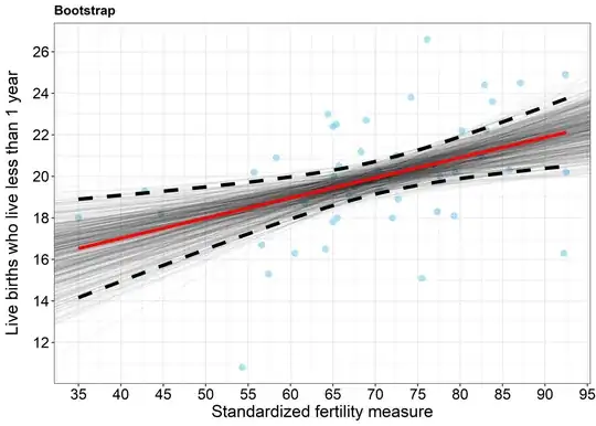

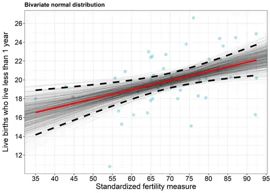

Here are two graphics, the first was generated by sampling 500 times from the bivariate normal distribution and the second one was generated by 500 nonparametric bootstrap replicates. The red line denotes the ols fit and the dashed black lines denote the 95% confidence intervals. The individual resampled regression lines are drawn in a translucent black so that the color is darker in regions were they overlap. You can see clearly that the majority of the resampled regression lines lie within the 95% confidence band, as we would expect.

library(MASS)
library(scales)
library(ggplot2)
library(reshape2)
mod <- lm(Infant.Mortality~Fertility, data = swiss)
Sigma <- vcov(mod) # The covariance matrix of the estimates
mu <- coef(mod) # The estimates
set.seed(142857)
n_sim <- 500      # Number of replicates
x <- mvrnorm(n = n_sim, mu = mu, Sigma = Sigma) # Sample from the bivariate normal distribution
rbind(x, c(mu))
plot_frame <- data.frame(
  int = x[, 1]
  , slope = x[, 2]
pred_frame <- data.frame(
  Fertility = seq(min(swiss$Fertility), max(swiss$Fertility), length.out = 1000)
pred_frame$lwr <- predict(mod, newdata = pred_frame, interval = "confidence")[, 2]
pred_frame$upr <- predict(mod, newdata = pred_frame, interval = "confidence")[, 3]
theme_set(theme_bw())
p <- ggplot(data = swiss, aes(x = Fertility, y = Infant.Mortality)) +
  geom_point(size = 3, colour = "#5CC3F0", alpha = 0.5, pch = 16) +
  geom_abline(data = plot_frame, aes(intercept = int, slope = slope), col = "black", alpha = 0.05) +
  geom_line(data = pred_frame, aes(x = Fertility, y = lwr), linetype = 2, size = 1.7) +
  geom_line(data = pred_frame, aes(x = Fertility, y = upr), linetype = 2, size = 1.7) +
  stat_smooth(method = "lm", se = FALSE, col = "red", size = 1.5, fullrange = TRUE) +
  xlab("Standardized fertility measure") +
  ylab("Live births who live less than 1 year") +
  ggtitle("Bivariate normal distribution") +
  scale_x_continuous(breaks = scales::pretty_breaks(n = 10)) +
  scale_y_continuous(breaks = scales::pretty_breaks(n = 10)) +
  theme(
    axis.title.y=element_text(colour = "black", size = 17, hjust = 0.5, margin=margin(0,12,0,0)),
    axis.title.x=element_text(colour = "black", size = 17),
    axis.text.x=element_text(colour = "black", size=15),
    axis.text.y=element_text(colour = "black", size=15),
    legend.position="right",
    legend.text=element_text(size=12.5),
    legend.key=element_blank(),
    plot.title = element_text(face = "bold"),
    strip.text.x=element_text(size=15)
# Bootstrap
set.seed(142857)
n_boot <- 500 # Number of bootstrap replicates
boot_res <- matrix(NA, ncol = 2, nrow = n_boot) # Matrix to store the bootstrap coefficients
# Start the bootstrap
for (i in seq_len(n_boot)) {
  boot_res[i, ] <- coef(lm(Infant.Mortality~Fertility, data = swiss[sample(seq_len(dim(swiss)[1]), replace = TRUE), ]))
boot_res <- data.frame(boot_res)
names(boot_res) <- c("int", "slope")
  geom_abline(data = boot_res, aes(intercept = int, slope = slope), col = "black", alpha = 0.05) +
  ggtitle("Bootstrap") +
  theme(
