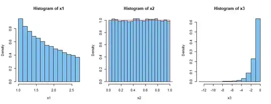

Then we show histograms of the three samples. At the left, notice that it is difficult to make an informative histogram of $X_1$ because it is so severely skewed to the right. In the center panel, we overlay the density function of $\mathsf{Norm}(\mu =50, \sigma=2);$ which is symmetrical. At the right, notice that taking (natural) logs once again results in a slightly left-skewed distribution.

(3) However, it is not always true that taking logs gives a smaller variance. If $X_2 \sim \mathsf{Unif}(0,1),\, X_1 = e^{X_2},$ and $X_3 = \ln(X_2),$ then R code similar to the code for the lognormal example gives the following results:
set.seed(720); n = 10^5
x2 = runif(n); x1 = exp(x2); x3 = log(x2)
var(x1); var(x2); var(x3)
[1] 0.2411124
[1] 0.08316279 # aprx V(X2) = 1/12
[1] 1.01091
