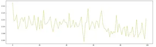

Let's calculate and plot the ratio:
ratio = control / test
plt.figure(figsize=(20, 6))
plt.plot(ratio, 'y--')
plt.show()

ttest(ratio[:70], ratio[70:])
Result:
normally distributed p=0.783668458064106
ttest difference significant p=2.1238045469602226e-11
Is this a valid approach?
Is it valid to use a t-test in such a setup?
