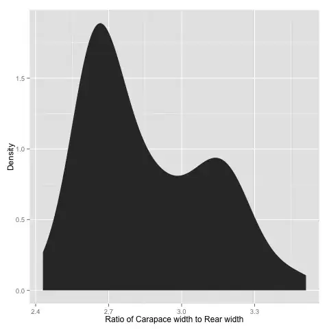

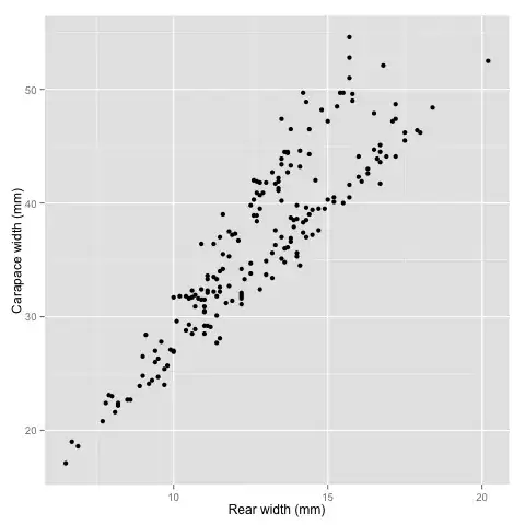

I am experimenting with machine learning and have been exploring example data sets in the R package. I am currently using the data(crabs) in the MASS package and trying to predict crab gender and species from morphological variables. I first looked at the PCA of the variables to identify underlying vectors within the data. The first component in the PCA is all positive with respect to each variable, and from my understanding of PCA this means the variables are all correlated along this component. The second component contains both positive and negative values, specifically carapace width and rear width. A dot plot and density plot of these variable indicates two possible distributions.
Plot of second component Plot of second component density
Is it therefore sensible to use the following logistic model for predicting species:
species ~ CW + RW + I(CW/RW)
As Stuart mentioned in the comments, these variables may be correlated with each other and therefore non-independent. I used bootstrapping of the crab data to test the models' accuracy. For the case of predicting sex, including the ratio term does seem to improve the model's predictive accuracy slightly.
Model Bootstrapping
I should also note that including all available measured variables improves the model accuracy but I would like to try and "infer" what the important variables may be using PCA.
