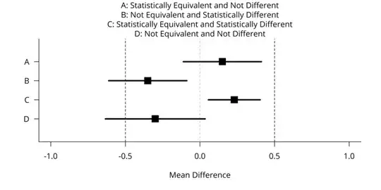

So instead of the dichotomy effect versus no-effect you should go for the following four categories:
four categories
Image from https://en.wikipedia.org/wiki/Equivalence_test explaining the two one sided t-tests procedure (TOST)
You seem to be in category D, the test is inconclusive. Your coworkers might be wrong to say that there is an effect. However, it is equally wrong to say that there is no effect!
