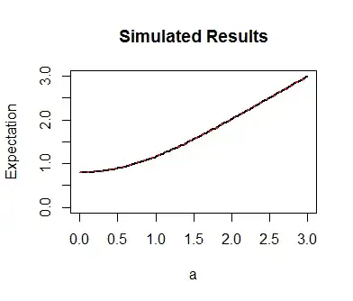

Finally, as a check, here is a quick (sub-second) simulation in R using a million draws from the standard Normal distribution. It plots the theoretical and simulated curves: they are identical.
x <- abs(rnorm(1e6))
sim <- sapply (a <- seq(0, 3, length.out=80), function(a) {
  c(mean(pmax(a, x)), a + 2*(dnorm(a) - a * pnorm(-a)))
plot(a, sim[2,], type="l", ylim=c(0,3), lwd=2, col="Black",
     ylab="Expectation", main="Simulated Results")
lines(a, sim[1,], type="l", ylim=c(0,3), lwd=2, col="Red", lty=3)
