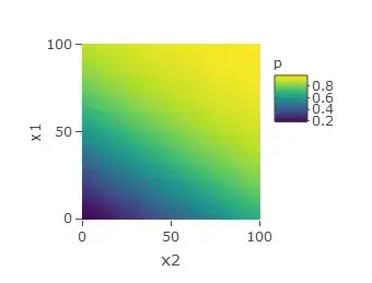

I have done a logistic regression with two independent variables (x1 and x2) and a dependent binary variable (y). The AUC (roc curve) is 0.7915.
The heatmap below shows the probabilities resulting from the predict function. It seems the logistic regression is not flexible enough since the range of p (probabilities) for x1=10 is 0.25 – 0.76 while in reality this range is 0.25 – 1.

  • You lost me when you stated the range of y is 0.25 - 0.76 after describing y as a "binary variable." To me, as well as to a great many other readers, the latter means y can have only the values 0 and 1. In light of this, I'm having trouble understanding what any of your graphs are trying to represent. Could you edit this question to clarify what you are working with and to explain the figures? – whuber Jul 02 '19 at 21:12
  • You've tagged this with [tag:mgcv] but state you used the gam package. Can you clarify what you are using? – Gavin Simpson Jul 02 '19 at 21:38
  • @Whuber these graphs are based on the predict functions. The binary variable is predicted with the logistic regression in the first two graphs and by using Group By resulting in an average for every combination of x1 and x2 (a Pivot table) as comparison in the third graph, resulting in the difference between a Pivot table and the GAM in the third graph. – user2165379 Jul 02 '19 at 22:04
  • @user2165379 That means the graphs haven't been characterized correctly. Note, too, that the predict function has several kinds of output you can specify: probabilities or log odds. – whuber Jul 02 '19 at 22:06
  • @ Gavin Simpson initially I used mgcv as you reacted on in this post https://stats.stackexchange.com/a/415358/131164 After trying several options with the parameters I have used the gam-package. I will discard mgcv, although I thought they where closely related so I thought I would reach more people by adding it. – user2165379 Jul 02 '19 at 22:09
  • @ whuber you are right. I will characterize the graphs in more detail. I used probabilities as output. I will add this in the post too. – user2165379 Jul 02 '19 at 22:12
