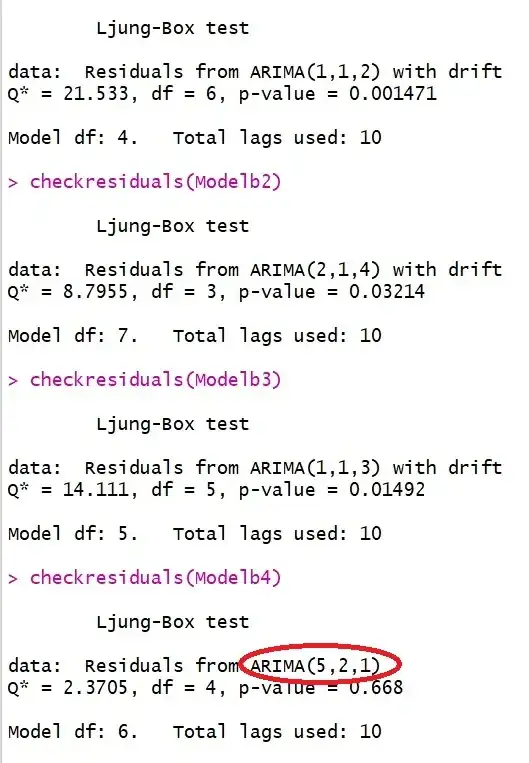

So this is the first question: is it possible that this effect is due to the small sample, disregardless of the model chosen? Or is it possible that I need to differentiate again in order to eliminate this issue? Among the models in the table, there are some that require differentiation a second time. Did that, tested for autocorrelation (again, using Ljung-Box test) in the residuals and couldn't reject the null. All this is shown in the next image: enter image description here
Am I failing to identify the presence of unit root after differentiation for the first time? Is it auto.arima as well as my function that created a pool of models failing to identify the need for a second differentiation? Or is there any explanation given the size of the data for this issue with the autocorrelation of residuals?
