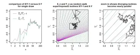

Stability
Below is an example for the variables $$\begin{array}{rcl} Z_1 &=& \frac{\bar{X}_n}{\bar{Y}_n} \\ Z_2 &=& {\bar{X}_n}-{\bar{Y}_n}\end{array}$$ with $$\begin{array}{cccc}\bar{X}_n &=& \frac{1}{n} (X_1, X_2, ... , X_n) & \qquad X_i \sim N(\mu_X=1,\sigma_X = 2) \\ \bar{Y}_n &=& \frac{1}{n} (Y_1, Y_2, ... , Y_n)& \qquad Y_i \sim N(\mu_Y=1,\sigma_Y = 2) \end{array}$$
$X_n,Y_n$ can be considered as a sort of random walk and as $n \to \infty$ you will get $X_n,Y_n \to \mu_X, \mu_Y$. You can see the distribution of $X_n,Y_n$ as a multivariate Gaussian that becomes more and more concentrated around the point $\mu_X, \mu_Y$ and this is like sort of zooming in to the point $\mu_X, \mu_Y$.
The distribution for the values of $Z_1$ and $Z_2$ can be imagined by superimposing to this random walk the isolines for values of $Z_1$ and $Z_2$. The lines for $Z_2$ are parallel and no matter what value of $n$ the statistic $Z_2$ is normal distributed. The lines for $Z_1$ are not parallel and the distribution for $Z_1$ is not normal distributed, but when you zoom in (when $n$ increases) the lines are more parallel, and the distribution of $Z_1$ becomes more and more normal distributed. In the case of $\mu_X=\mu_Y=1$ you will even get that $Z_1$ and $Z_2$ become as close as you wish for sufficiently large $n$.
example
  • Note while the distribution for $\bar{X}_n/\bar{Y}_n$ is asymptotically normal distributed for $n \to \infty$ (see also https://stats.stackexchange.com/a/399952/164061 ) it will still have some sort of Cauchy/Lorentz distribution component and an expression of stability in terms the standard deviation (or error) is not defined.
    But the good news is that in practice we often do not have truly a normal distribution. So when your grades are always positive (no negative and zero values as the normal distribution would technically include as well) then the ratio will have a defined and finite deviation/variance.
  • Note that the image above has $Z_1$ and $Z_2$ become equal for large $n$. But this will only hold for $\mu_X=\mu_Y=1$. You will not in general get the same sample variance for $Z_1$ and $Z_2$, this is even true when $\mu_X = \mu_Y$.
    In the image you can use the distance between the iso-lines as a measure for the standard deviation. When the lines are close to each other then changes in $X_n,Y_n$ will make large differences in the statistic. When the lines are far from each other then changes in $X_n,Y_n$ will make small differences in the statistic.
    You can see that neither $X/Y$ or $X-Y$ is the best in every region. $X/Y$ will 'perform' better when $X,Y$ are large and $X-Y$ will 'perform' better when $X,Y$ are small. If you would draw some boundary lines for a hypothesis test like $a < X/Y < b$ and $c < X-Y < d$, then the regions will be different geometries. The statistical test $a < X/Y < b$ will relate to a region in the shape of a cone. The statistical test $c < X-Y < d$ will relate to a region in the shape of a diagonal bar. These regions will not reject/accept all cases the same. One region will be more strict close to the origin, the other will be more strict far away from the origin.
