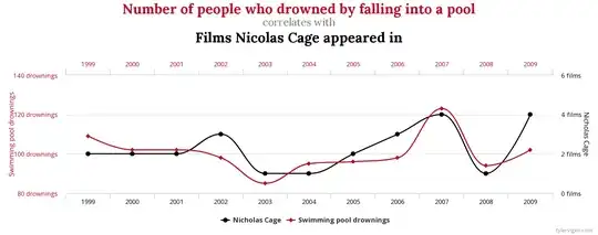

Maybe this is helpful for some people sharing the same intuitive understanding. We've all seen something like this:
These data are presumably independent but clearly exhibit correlation ($r = 0.66$). "I thought independence implies zero correlation!" the student says.
As others have already pointed out, the sample values are correlated, but that does not mean the population has nonzero correlation.
Of course, these two should be independent—given Nicolas Cage appeared in a record-setting 10 films this year, we shouldn't be closing the local pool for the summer for safety purposes.
But when we check how many people drown this year, there is a small chance that a record-setting 1000 people drown this year.
Getting such correlation is unlikely. Maybe one in a thousand. But it's possible, even though the two are independent. But this is just one case. Consider that there the millions of possible events to measure out there, and you can see the chance that the odds of some two happening to give a high correlation is quite high (hence the existence of graphs such as that above).
