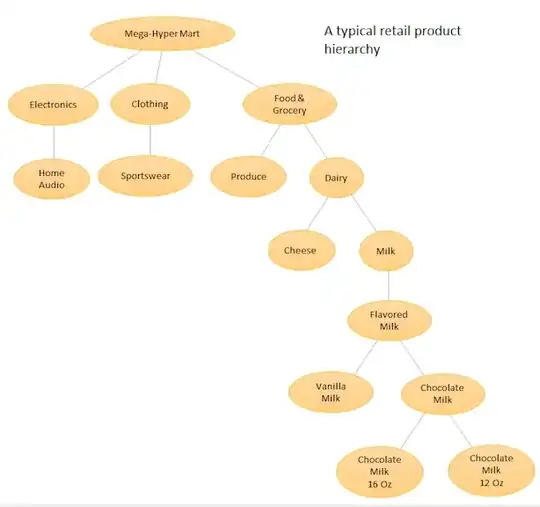

Much more common, including what my team currently uses, is hierarchical forecasting (see here as well). Hierarchical forecasting is used whenever we have groups of similar time series: Sales history for groups of similar or related products, tourist data for cities grouped by geographical region, etc...
The idea is to have a hierarchical listing of your different products and then do forecasting both at the base level (i.e. for each individual time series) and at aggregate levels defined by your product hierarchy (See attached graphic). You then reconcile the forecasts at the different levels (using Top Down, Botton Up, Optimal Reconciliation, etc...) depending on the business objectives and the desired forecasting targets. Note that you won't be fitting one large multivariate model in this case, but multiple models at different nodes in your hierarchy, which are then reconciled using your chosen reconciliation method.
The advantage of this approach is that by grouping similar time series together, you can take advantage of the correlations and similarities between them to find patterns (such a seasonal variations) that might be difficult to spot with a single time series. Since you will be generating a large number of forecasts that is impossible to tune manually, you will need to automate your time series forecasting procedure, but that is not too difficult - see here for details.
