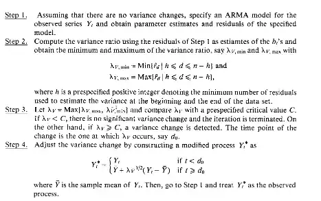

Here is the data enter image description here which clearly suggests that as the series gets higher the variability increases. An even "truer" statement is that the variance changes at one point in time (around period 54) and not pervasively suggesting that a Weighted least Squares would be more appropriate than a Log Transform . This will be found via the TSAY test described here https://onlinelibrary.wiley.com/doi/abs/10.1002/for.3980070102 with an excerpt here enter image description here
The TSAY test shown here enter image description here led to a first difference model (nearly second differences as suggested by the ar coefficients nearly summing to 1.0 ) here enter image description here with 9 pulses/shocks and a positive level shift (intercept change) at period 68.

In summary a useful model requires that the data be treated for non-constant variance by employing Weighted Least Squares effectively discounting the values 54-132 . The arima model is (2,1,0)(0,0,0)12 with a constant and 1 level shift along with 9 pulses.

  • "a Weighted least Squares would be more appropriate than a Log Transform" Does this mean you are using WLS to change multiplicative data into additive data? Do you have a reference for this? – Frank Jun 10 '19 at 23:04
  • See https://onlinelibrary.wiley.com/doi/abs/10.1002/for.3980070102 and in particular this excerpt – IrishStat Jun 11 '19 at 01:44
  • see https://stats.stackexchange.com/questions/412230/seasonality-after-1st-differencing/412231#412231 for the excerpt where the w's are developed inversely related to the cahnge in variance . Portion of the data is multlplied by a constant ...the resultant data can then be modeled with an additive model – IrishStat Jun 11 '19 at 01:54
