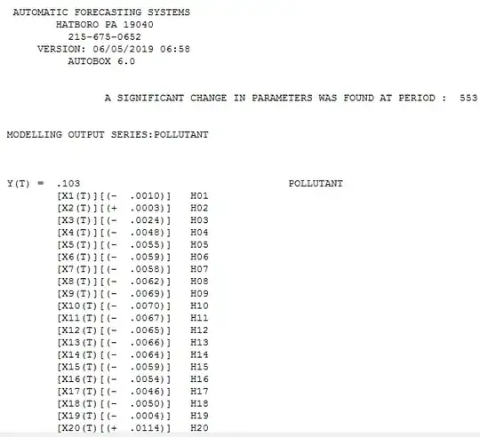

AUTOBOX detected a break point in parameters and segmented the data into 552 and 168 sections. The most recent 168 values yielded the following Actual/Fit and Forecast enter image description here.
The model is presented here enter image description here and here enter image description here
