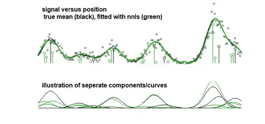

    Example: the graph below which displays the results of a toy-model for some signal that is a linear sum of 10 Gaussian curves (this may for instance resemble an analysis in chemistry where a signal for a spectrum is considered to be a linear sum of several components). The signal of the 10 curves is fitted with a model of 100 components (Gaussian curves with different mean) using LASSO. The signal is well estimated (compare the red and black curve which are reasonably close). But, the actual underlying coefficients are not well estimated and may be completely wrong (compare the red and black bars with dots which are not the same). See also the last 10 coefficients:
                  91     91     92     93     94     95     96     97     98     99     100
     true model   0      0      0      0      0      0      0      142.8  0      0      0
     fitted       0      0      0      0      0      0      129.7  6.9    0      0      0
    The LASSO model does select coefficients which are very approximate, but from the perspective of the coefficients themselves it means a large error when a coefficient that should be non-zero is estimated to be zero and a neighboring coefficient that should be zero is estimated to be non-zero. Any confidence intervals for the coefficients would make very little sense.

    As a comparision, the same curve can be fitted with a stepwise algorithm leading to the image below. (with similar problems that the coefficients are close but do not match)
    example nnls

  • +1 Thank you Martjin Wterings. Can you amplify the graph a bit? What is shown on the axes, what color represents, etc.? – Alexis Sep 12 '19 at 15:49
  • Actually, the graph is not a case of LASSO. However, it is an example how a model may be some sum of several components, say a Gaussian curves (where the curves with a slightly different mean are very correlated) and a shift in the mean of those components means a big change for the coefficient but not so much for the curve. – Sextus Empiricus Sep 12 '19 at 16:07
    The bars are the values of the coefficients for the true and the fitted model. This is the image for which I remember this principle occuring. I will make an example myself, that may show it more clearly (I suspect that LASSO, being less greedy, might perform somewhat better in representing the true coefficients). – Sextus Empiricus Sep 12 '19 at 16:11
