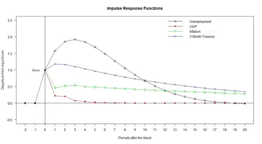

Rather than try to interpret the coefficients in each equation, let's plot the impulse response functions (IRFs) and interpret them instead. The graph below shows the impulse response functions associated with each of these models.
Don't take this as a masterclass in interpreting IRFs - think of it more like a basic introduction - but anyway, to help us interpret the IRFs we'll need to accustom ourselves with two concepts; momentum and persistence.
These two concepts are defined in Leamer (2010) as follows:
Momentum: Momentum is the tendency to continue moving in the same direction. The momentum effect can offset the force of regression (convergence) toward the mean and can allow a variable to move away from its historical mean, for some time, but not indefinitely.
Persistence: A persistence variable will hang around where it is and converge slowly only to the historical mean.
Equipped with this knowledge, we now ask the question: suppose a variable is at its historical mean and it receives a temporary one unit shock in a single period, how will the variable respond in future periods? This is akin to asking those questions we asked before, such as, do the forecasts contains cycles?, how quickly do the forecasts converge to the mean?, etc.
At last, we can now attempt to interpret the IRFs.
Following a one unit shock, the unemployment rate and short-term interest rate (3-month treasury) are carried further from their historical mean. This is the momentum effect. The IRFs also show that the unemployment rate overshoots to a greater extent than does the short-term interest rate.
We also see that all of the variables return to their historical means (none of them "blow up"), although they each do this at different rates. For example, GDP growth returns to its historical mean after about 6 periods following a shock, the unemployment rate returns to its historical mean after about 18 periods, but inflation and short-term interest take longer than 20 periods to return to their historical means. In this sense, GDP growth is the least persistent of the four variables while inflation can be said to be highly persistent.
I think it's a fair conclusion to say that we've managed (at least partially) to make sense of what the four ARIMA models are telling us about each of the four macro variables.
