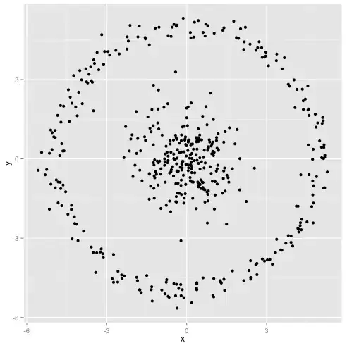

I would like to create a random data sample to test a clustering algorithm using python. One specific data sample I would like to generate consists of two non-overlapping annuluses (annuli?); however, it's okay if the inner-most annuli is a circle - as in the image below (taken from this question).
example data
I realize that I can sample N values of angles ti such that 0 ≤ ti ≤ 2 pi. Based on some reading online, I think one can generate N samples of circular data by specifying a fixed radius r such that xi = r cos(ti) and yi = r sin(ti). Applying this reasoning to the desired annulus, I am thinking one can repeat the process for variable radii rmin and rmax; however, I am not sure how to proceed from this point. My thinking is to generate n samples of radii ri (where n < N, the annulus cluster is a subset of all the data) such that rmin ≤ ri ≤ rmax; doing so necessarily means the first cluster should be the n points within the the outer-most annulus and the second cluster should be the N-n points within the inner-most annulus/circle.

    Your approach will suffer from the problem the poster in the proposed duplicate pointed out, with a higher density near the center than near the outer boundary. This will afflict both the annulus and the disk, but more so the disk. whuber's answer in the proposed duplicate directly gives you the disk part, and by constraining the part where rho is generated, you get the annulus. – Stephan Kolassa May 05 '19 at 03:59
  • Is my approach of varying the radius between rmin and rmax the proper way to "constrain the part where rho is generated"? –  May 05 '19 at 04:01
whuber's answer in the proposed duplicate directly gives you the disk part, and by constraining the part where rho is generated, you get the annulus. Note that you need to constrain "on the square root scale".
Here is an adoption of whuber's original R code, which should be easy to translate to Python:
outer_radius <- 1
inner_radius <- 0.7
n <- 1e4
rho <- sqrt(runif(n,inner_radius^2,outer_radius^2))
theta <- runif(n, 0, 2*pi)
x <- rho * cos(theta)
y <- rho * sin(theta)
plot(x, y, pch=19, cex=0.6, col="#00000020")
annulus
