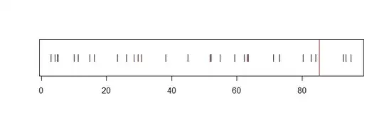

With only $n = 30$ observations, we can't expect any one of the observations to be really close to the 90th percentile of the actual distribution (whatever it may be). Also, if the right tail of the actual distribution is longer it will be harder to find the 90th percentile. Let's try three distributions, and see how well bootstrapping works.
Uniform Data. Suppose the data are from $\mathsf{Unif}(0,100),$ for which $90$ is the 90th percentile. Below we that the 90th percentile of the sample of 30 is $85.3$. Also, 95% of bootstrapped samples had 90th percentiles in the interval $(71.36, 93.79).$ So the bootstrap CI captures what we know in this simulated example to be the true 90th percentile of the population distribution.

Of the 100,000 bootstrap re-samples from the exponential sample (each of size 30) there were only 86 uniquely different 90th percentiles. Here is the histogram of the bootstrap distribution. Small tick marks show positions of of the 86 values; some tick marks represent many re-samples with the same 90th percentile. Vertical dotted lines show the limits of the 95% quantile-method bootstrap confidence interval.
Notes: (1) Different software programs have slightly different methods of defining quantiles that can give noticeably different results for small samples. For each original sample the 90th percentile (according to R's default definition), are shown on the respective stripcharts.
(2) For a particular distribution, nonparametric bootstrap procedures based on small samples may give noticeably different results--from one small sample from to another. [Here, seeds are given so you can reproduce the same samples used to get results in the Answer.] As the histogram for the last part (exponential data) shows, bootstrap distributions based on small samples may be discrete in unexpected ways.

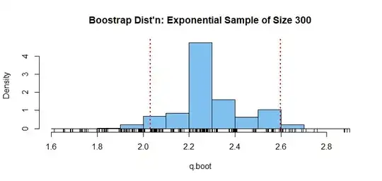

Addendum: We tried the same nonparametric bootstrap method, but using an exponential sample of size $n = 300.$
The bootstrap procedure results in over 300 uniquely different 90th percentiles and the 95% confidence interval $(2.03, 2.60)$--much narrower than for $n=30.$
