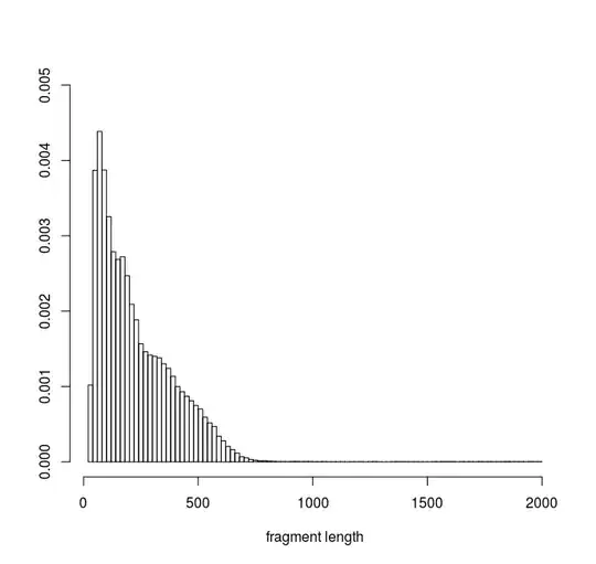

I would like to figure out which distribution fits my data best.
Here is the histogram of my data :
I used the fitdistrplus package in R to try to find the best fit for my data. To get an idea of which family distribution to fit, I did this:

So apparently no distribution is a good candidate for the data. How to interpret this plot ? Does this mean that my data is a mixture of several distributions ?
EDIT :
This distribution represents DNA fragment lengths obtained from an experiment. My aim is to be able to simulate the result of this experiment by simuating the resulting fragments. (i.e a simulated fragment is defined by two positions in the genome seperated by a distance D). I assume that the fragment length distribution observed from the real experiment can be described by a density function or a mxiture of densities. I am looking fo the best function from which I could sample values of D for my simulations.
To note, I am using only a sub sample to fit a distribution. We generate millions of fragments. I work on subsample of 500.000 fragments.

Your data looks like a mixture to me: there seems to be one component with a mean fragment length of 100 nt, one around 200 nt and another with a mean fragment length around 300 nt (you can see 'bumps' in the histogram).
Is there anything about how the library was prepared that would explain why there is more than one component in the mixture?
I would fit a mixture of 3 Gaussians to the data. I use the R package mixtools. Edit: to check goodness of fit, you might try this function: https://rdrr.io/cran/AdaptGauss/man/Chi2testMixtures.html

  • Thank you for your answer. The experiment is an ATAC-seq experiment on Arabidopsis Thaliana, which allows the characterization of accessible regions of chromatin. Then the first 'bumps' corresponds to the fragment without nucleosome (open chromatin), the second to fragments with 1 nucleosome... – Louna_DO Apr 24 '19 at 09:43
  • That makes a lot of sense. As Glen_b commented above, it might be worth trying 4 or 5 components in the mixture - you already have a clear expectation about what the mean of each Gaussian should be, so you can safely add more components to the mixture as long as the estimated means are as they are expected to be. – Jay Moore Apr 24 '19 at 09:56
  • As you suggested in your answer, I used the package mixtools for fit a mixture of several Gaussians. But I don't understand how check the goodness of fit of a Gaussian mixture using the package vcd. – Louna_DO Apr 24 '19 at 12:14
  • I'm sorry, the goodfit function in vcd is only for poisson, binomial and negative binomial. I did find this function Chi2testMixtures which carries out a goodness of fit test for a mixture of Gaussians: https://rdrr.io/cran/AdaptGauss/man/Chi2testMixtures.html – Jay Moore Apr 24 '19 at 12:30
