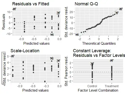

My first issue is that I have used the function 'autoplot' to test assumptions, and the normal Q-Q plot is skewed:
autoplot results
I am unsure whether or not it is okay to proceed with fitting the anova, or how to adjust my data if it is not ok to proceed.

Most of those plots don't make a lick of sense for a GLM, at least not for the binomial (or quasi-binomial) models. The "theoretical" quantiles are still drawn from a normal (0, 1) distribution even when the prevalence of the outcome is very low (meaning that errors are likely to be skewed even after standardizing by variance).
Fitting the quasi-likelihood model is extra insurance against some of the more important (not depicted) modeling assumptions. See my post here about quasilikelihood models.
