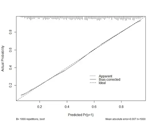

What you can do is estimate true response probabilities and how reflective of them your model is. This is called "calibration". The Python package sklearn has a calibration method, as does the R package rms that I demonstrate below.
library(rms)
set.seed(2023)
N <- 1000
x1 <- runif(N)
x2 <- runif(N)
z <- 3*x1 - 3*x2
p <- 1/(1 + exp(-z))
y <- rbinom(N, 1, p)
L <- rms::lrm(y ~ x1 + x2, x = T, y = T)
cal <- rms::calibrate(L, B = 1000)
plot(cal)
Calibration plot
Ideally, the calibration curve will equal the line $y=x$, since we want the probability of event occurrence to equal the predicted probability. Since the calibration curve is close to the $y=x$ line, the calibration seems to be pretty good. When you do something like this for your model, you may find that it lacks calibration. Examples of models that lack calibration are given in the sklearn documentation.
