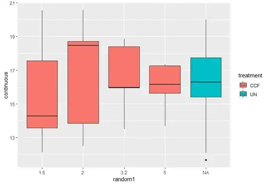

This is the boxplot by treatments (colours are random1)

There are some issues with your dataset:
1) Plot the data:
Straight away, we can see that there may be little hope of finding a significant treatment effect.
2) The factor random2 has only 2 levels, and this is not sufficient to warrant fitting random intercepts. The software will try to estimate a variance for a normally distributed variable with only 2 observations. This can not result in a meaningful estimate and you should not model this factor as random using lme4.
3) The factor random1 has 15 of 35 observations missing. Moreover these 15 observations correspond to ALL of the observations of a single random2 level.
Even after removing random2 as a random effect, there is still a singular fit. This is because there is virtually no intra-class correlation, so there is no need to fit random effects at all, with these data.
One way forward is to include random2 as a fixed effect - as if it were a potential confounder (so you would not try to interpret it's coefficient):
model1.6 <- lm(continuous ~  treatment + random2, data= df)
Residuals:
    Min      1Q  Median      3Q     Max
-4.9496 -1.9370 -0.0953  1.9567  4.3314
Coefficients:
            Estimate Std. Error t value Pr(>|t|)
(Intercept)  16.2371     0.5454  29.771   <2e-16 ***
treatmentUN  -2.2660     1.8089  -1.253    0.219
random22      2.6211     1.8526   1.415    0.167
Residual standard error: 2.439 on 32 degrees of freedom
Multiple R-squared:  0.05887,   Adjusted R-squared:  4.796e-05
F-statistic: 1.001 on 2 and 32 DF,  p-value: 0.3788
It is hardly surprising that treatment is not significant, but this does handle the possible non-independence of observations due to clustering in random2. Note that we cannot do the same for random1 due to the extent of missing values.
