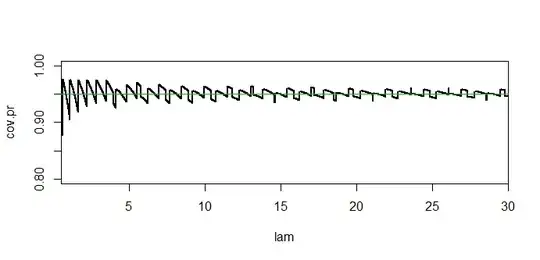

Because a Poisson distribution is discrete, actual coverage probabilities can vary by a surprising amount with a small change in the value of $\lambda.$ Here is a graph that shows actual coverage probabilities of the second (small $\lambda)$ type of "95%" confidence interval given above, for many values of $\lambda$ between $0.5$ and $30.$ For $\lambda > 5,$ coverage probabilities are not far from 95%.
The figure was made using the following R code:
lam = seq(.5, 30, by=.0001); m = length(lam) # values of lambda
t = 0:200 # realistic values of T
LL = t+2 - 1.96*sqrt(t+1); UL = t+2 + 1.96*sqrt(t+1) # corresp. CIs
cov.pr = numeric(m)
for(i in 1:m) {
lam.i = lam[i] # pick a lambda
cov = (lam.i >= LL & lam.i <= UL) # TRUE if CI covers
cov.pr[i] = sum(dpois(t[cov], lam.i)) } # sum probs for covering T's
plot(lam, cov.pr, type="l", ylim=c(.8,1), lwd=2, xaxs="i")
 abline(h=.95, col="green3")
