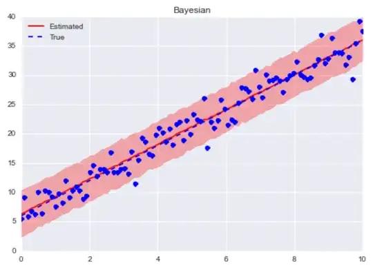

However, when I re-run my MCMC, I get very different results. As a sense check, I tried a simple OLS linear regression using the same code.
With my original (not normalised) likelihood, I get sensible results: the MCMC recovers the "true" parameters and the 95% CI broadly agrees with the Frequentist results from 'statsmodels':
Original (not normalised) likelihood
However, with the "normalised" likelihood, I get very different (and obviously wrong) results:

What am I missing/misunderstanding to reconcile these two results, please? On the one hand, it's OK to ignore the "normalising constant" in Bayes' equation, because anything proportional to the log-posterior is sufficient. On the other hand, multiplying the log-posterior by a constant $\frac{1}{n}$ seems to have a dramatic effect on my results?
