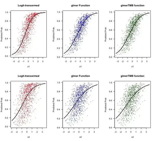

6. Let's look at some visualizations.

#Plot it
par(mfrow = c(2,3))
plot(df$x1, (exp(predict(test.lme))/(1+exp(predict(test.lme)))), pch = 16, cex = 0.4, col = 'red', xlab = 'x1', ylab = 'Predicted Prob.', main = 'Logit-transormed')
lines(predicted.df.x1$x1[1:1000], predict.lme.x1[1:1000], col = 'black', lwd = 2)
plot(df$x1, predict(test.glmer, type = 'response'), pch = 16, cex = 0.4, col = 'blue', xlab = 'x1', ylab = 'Predicted Prob.', main = 'glmer Function')
lines(predicted.df.x1$x1[1:1000], predict.glmer.x1[1:1000], col = 'black', lwd = 2)
plot(df$x1, predict(test.glmmTMB, type = 'response'), pch = 16, cex = 0.4, col = 'darkgreen', xlab = 'x1', ylab = 'Predicted Prob.', main = 'glmerTMB function')
lines(predicted.df.x1$x1[1:1000], predict.glmmTMB.x1[1:1000], col = 'black', lwd = 2)
plot(df$x2, (exp(predict(test.lme))/(1+exp(predict(test.lme)))), pch = 16, cex = 0.4, col = 'red', xlab = 'x2', ylab = 'Predicted Prob.', main = 'Logit-transormed')
lines(predicted.df.x2$x2[1:1000], predict.lme.x2[1:1000], col = 'black', lwd = 2)
plot(df$x2, predict(test.glmer, type = 'response'), pch = 16, cex = 0.4, col = 'blue', xlab = 'x2', ylab = 'Predicted Prob.', main = 'glmer Function')
lines(predicted.df.x2$x2[1:1000], predict.glmer.x2[1:1000], col = 'black', lwd = 2)
plot(df$x2, predict(test.glmmTMB, type = 'response'), pch = 16, cex = 0.4, col = 'darkgreen', xlab = 'x2', ylab = 'Predicted Prob.', main = 'glmerTMB function')
lines(predicted.df.x2$x2[1:1000], predict.glmmTMB.x2[1:1000], col = 'black', lwd = 2)
So the result we get from the logit-transformed response variable with the linear nlme is slightly different from outputs provided using the glmer and glmmTMB when specifying the binomial family. It also doesn't take too much to see that there is a difference between the methods when looking at the visuals.
Now the question is why is it different. I'm sure there is an answer, I just don't know what it is.

  • thank your for that detailed answer! I'll certainly make use of that! – Toby May 23 '19 at 10:53
  • @Lalochezia: Somehow I missed that you tagged me to your nice answer. Better to join the party late than never, as they say. Applying the logit-transform to your response variable and then analyzing it with lme() means that you are modelling the expected value of the logit transformed response variable given the predictors and random effects. On the other side, with glmer() or other alternatives, you are modelling the logit transformed expected value of the response variable given the predictors and random effects. These two are entirely different quantities. – Isabella Ghement Dec 08 '20 at 16:27
  • The logit transformation is a non-linear transformation, so the expected value of the logit transformed response variable given all else in the model is NOT the same as the logit transformed expected value of the response. What we really want to model is the latter, because we can use the inverse logit transformation to our advantage to learn more about the expected value of the response variable as a function of predictors and random effects. With the former, interpretability is a big concern. – Isabella Ghement Dec 08 '20 at 16:31
  • Because the two approaches model entirely different things, it is not surprising that their results are different. In practice, the approach which produces the most interpretable results should be favoured. – Isabella Ghement Dec 08 '20 at 16:34
