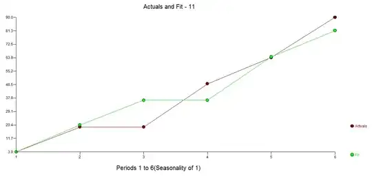

For example I took series 11 and obtained enter image description here enter image description here

After considering two options :
1) Build a model using a PREDICTOR SERIES of the form 1,2,3,4,5,6
2) Build a model optimally using the history of prior values (ARIMA)
the tournament ( i.e. set of trials) concluded the the best model was 2) which meant that the prediction at any one point would be to use the most recent value and add 17.4 . The graph shows the Actual and the 1 period out prediction at each point in time IN GREEN.
I have taken your 79 series of length 6 and created 79 png files showing the actual and the fitted/predicted values which represent the equation . If you contact me at dave@autobox.com , I will be happy to send them to you along with the companion equation files. I just don't know how to attach them to this post.
