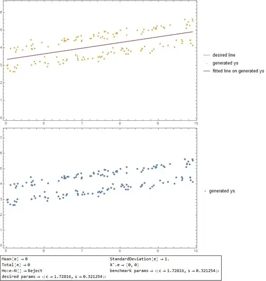

I have tried producing $u$ such that for $g=X'u$, $g'g$ is minimized but the result does not produce reasonably looking $y$'s even though when the $y's$ are used in the direct problem as a dependent variable yields the desired $b^*$'s.
(The generated $y$ data seem to be evenly dispersed above and below the regression line, leaving a narrow corridor around the regression line empty, as illustrated below:
