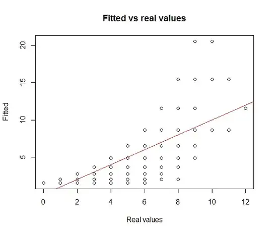

Hence, we fit a glm with Poisson process and check the fit and Pearson residuals:
plot(dat$Dependent, fitted(glmPoisson), main="Fitted vs real values", xlab="Real values", ylab = "Fitted")
abline(0,1, col="red")
plot(fitted(glmPoisson), residuals(glmPoisson, type = "pearson"), main="Fitted vs Pearson residuals", ylab="Pearson residuals", xlab = "Fitted")
From these simple plots, we clearly see that the fit is awful and residuals are clearly showing a pattern. Also, it is not able to model unseen data by the same process:

Hence:
  1. Why, even if the underlying process is Poisson, the model is better when Gaussian?
  2. In general, how can one decide a-priori the functional process, given that even in this simulated case we would have got the model completely wrong?

    You haven't indicated how you performed the original fit. Most likely it used a default log link rather than the linear link you used to generate the data. It's wonderful how clearly your results demonstrate the model you used is the wrong one! – whuber Mar 08 '19 at 13:07
    What matters is not the marginal distribution of your dependent variable (shown in your first histogram) but its conditional distribution given your independent variable $x$. This conditional distribution is not Poisson but a shifted Poisson distribution with a constant variance and mean depending linearly on $x$. Since the variance is constant, ordinary linear regression will be appropriate and robust given a sufficient sample size. – Jarle Tufto Mar 08 '19 at 13:10
    @whuber Gotcha! Good point. I did not think about that. I exactly used a log-link when fitting the Poisson – OnlyAL Mar 08 '19 at 15:27
