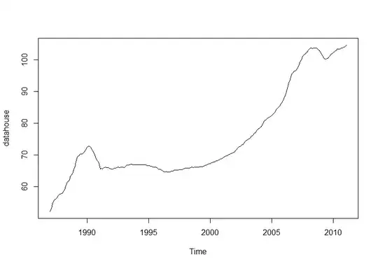

I am trying to fit a time series model for household data which is a time series variable. Initially my data looks like this, enter image description here
Since the data does not seem to be stationary I differenced the data.
When I plot the 2nd difference data, it looks like follows:
The plots didn't improve when I took a higher order difference. So I used the 2nd difference data.

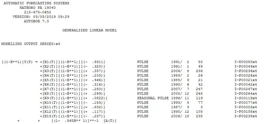

You politely asked "My question is about how to improve this model further . Because you will see that residuals are not normally distribute" . I have answered .....
I took your 290 monthly values (1987/1) and introduced them to AUTOBOX which automatically identified the following model.
1) ARIMA (1,1,0)(0,0,0)12 WITH AR COEFFICIENT=.865 THUS THIS IS VERY CLOSE TO SECOND DIFFERENCES WHICH YOU HAD CONSIDERED
2) 1 SEASONAL PULSE (POSITIVE) STARTING IN NOVEMBER 1996
3) 12 UNUSUAL VALUES (PULSES)
4) TWO MODEL ERROR VARIANCE CHANGES A) DOWNWARDS AT PERIOD 60 (1991/12) AND UPWARDS AT PERIOD 174 (2001/6) ... BOTH VISUALLY OBVIOUS FROM YOUR GRAPHS
This is the model enter image description here
The Actual,Fit and Forecast is here enter image description here with forecasts (and 95$ monte carlo based) hereenter image description here
The procedure following Tsay https://pdfs.semanticscholar.org/09c4/ba8dd3cc88289caf18d71e8985bdd11ad21c.pdf to identify variance change points yielded enter image description here
The model residuals are here enter image description here
The reasons that your software's attempt to model this data failed is that the original data is compromized by complications or opportunities.
