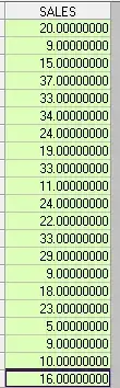

I used AUTOBOX and took 21 values representing three distinct subjects ( 7 values each) enter image description here and specified an ar(1) model here
The idea is that the last point of first series and first point of second series should be restricted from affecting the model coefficients.
I directed that there were 3 groups here enter image description here
The results shown here detail how the 1st , 8th and 15th residual were restricted to 0.0
with final model here reflecting a pooled estimate enter image description here and here enter image description here
