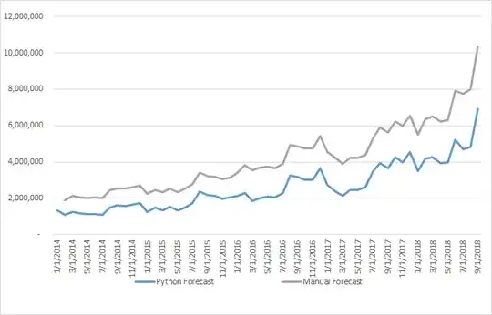

I'm trying to manually replicate the forecast that I obtained using statsmodels.api sarimax (python). Its actually just an AR(1) model with one exogenous variable, in the form of SARIMAX(1,0,0)(0,0,0)12
The results obtained using the statsmodels library are as follows:
Python forecast output
The obtained function is y_t = 1088 + 0.6145*y_t-1 + 185500*x (see image above) Nonetheles, when I manually input those values into the function, my results are very different.
Difference between python and manually calculated
I would very much appreciate if someone could give me a hint on what I'm doing wrong regarding the manual calculation.

The issue is that the model you are thinking of is an ARMAX model, like:
$$y_t = \mu + \beta x_t + y_{t-1} + \varepsilon_t$$
But Statsmodels fits a regression with ARMA errors. So the model in statmodels is:
$$ y_t = \beta x_t + u_t \\ u_t = \mu + \eta_{t-1} + \zeta_t \\ $$
It looks like you probably did something like the following in Statsmodels:
mod = sm.tsa.SARIMAX(endog, order=(1, 0, 0), trend='c', exog=exg)
res = mod.fit()
To reconstruct the forecast from Statsmodels, you can do the following:
# Compute u_t for in-sample values
ut_insample = endog - (185500 * exog)
# Forecast u_T+h for h = 1, ..., 10
ut_forecast = np.zeros(10 + 1)  # e.g. to forecast 10 periods
ut_forecast[0] = ut_insample[-1]
for t in range(1, len(ut_forecast)):
    ut_forecast[t] = 1088 + 0.6145 * ut_forecast[t-1]
ut_forecast = ut_forecast[1:]
# Get the forecast you want by adding back in the
# effect of the exogenous variables
# Note: this assumes that you have some values `exog_forecast` available
endog_forecast = 185500 * exog_forecast + ut_forecast
