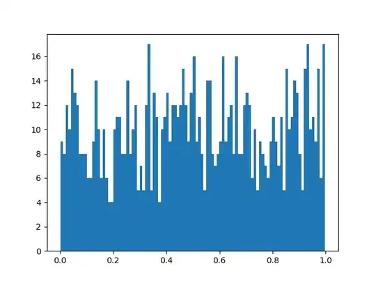

Running the following Python code, I often get very small p-values, sometimes even around 0.01.
a, b = np.random.normal(0,1,100000), np.random.normal(0,1,100000)
ttest_ind(a,b).pvalue
As the mean and std are the same and my sample size is pretty large, I'd expect getting p-values that are far away from zero.
Here is a histogram of the p-values I'm getting: p-values-hist
Why does this happen?
    That's a seriously wrong histogram if in fact it represents a large number p-values from tests of the null distribution! It should look nearly flat and horizontal: see https://stats.stackexchange.com/search?q=p-value+uniform. How many tests does it reflect? – whuber Feb 16 '19 at 22:35
    It looks pretty uniform to me -- just with a lot of bins relative to the number of observations; looks like 100 bins, so with the average looking close to 10, presumably the count in each bin would be binomial(1000,0.01) (which I admit is odd given the larger number the code indicates). The histogram looks reasonably consistent with that binomial (perhaps also with some allowance for some program-choice of bin origin and width based on the sample). – Glen_b Feb 16 '19 at 23:41
    @Michael If H0 is true, what is the probability that $p\leq\alpha$ for any $\alpha$? (i.e. what is the probability of a type I error?). As whuber indicates many posts on site discuss this issue. – Glen_b Feb 16 '19 at 23:50
