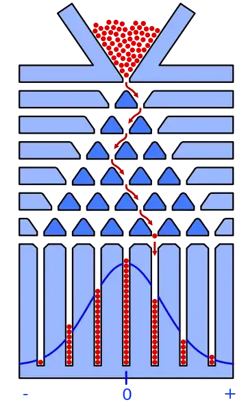

Edit: added illustration
Here's an illustration of a Galton Board that will make it much clearer what the differences between trials and observations are:
Galton Board
Each ball's path represents one observation (red arrows) passing through 6 left/right decisions or six trials (blue triangles) eventually ending up in one of the bins. The exact probability ($Pr$) of landing in one of the bins can be calculated using the binomial probability mass function $$Pr(X = k) = {n \choose k}p^k(1 - p)^{n-k},$$ where $X$ represents a random variable, $k$ the number of successes (e.g. bounce left), $n$ the number trials, and $p$ the probability of the outcome of each trial.
In R you can use the dbinom() function to calculate the exact probabilities of falling in each of the bins (from left to right and assuming $p=0.5$):
dbinom(6, 6, .5)
#[1] 0.015625
dbinom(5, 6, .5)
#[1] 0.09375
dbinom(4, 6, .5)
#[1] 0.234375
dbinom(3, 6, .5)
#[1] 0.3125
dbinom(2, 6, .5)
#[1] 0.234375
dbinom(1, 6, .5)
#[1] 0.09375
dbinom(0, 6, .5)
#[1] 0.015625
Or through simulation (in this case 100,000 observations and 6 trials):
bounces <- rbinom(100000, 6, .5)
mean(bounces == 6)
#[1] 0.01554
mean(bounces == 5)
#[1] 0.09325
mean(bounces == 4)
#[1] 0.23468
mean(bounces == 3)
#[1] 0.31349
mean(bounces == 2)
#[1] 0.23486
mean(bounces == 1)
#[1] 0.09287
mean(bounces == 0)
#[1] 0.01531
