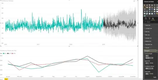

I've tried ets, tbats, and arima - I can't seem to get anything but a straight line out of this.
Example I tried:
hbf_ts2 <- msts(hbf$TheValue, seasonal.periods = c(7, 365.25))
fit2 <- tbats(hbf_ts2)
fc2 <- forecast(fit2, h=60)
plot(fc2)
Putting this into the PowerBI forecaster though yielded a meaningful forecast with no problem (2 mins, 2 maxes at the appropriate times of the forecasted year).
Edit: Added PowerBI pic showing what I believe are correct mins around mar/apr & sep/oct and maxes around jul/aug & dec. My question can be interpreted as: how to reverse engineer what PowerBI sees? enter image description here
Can somebody show me how to get a forecast to pick out the pattern(s) in this data?

Why do methods like tbats() give you a flat line forecast? Time series (like any other data with a random component) consist of signal and noise. Classical signals are trend, seasonality, autoregression and moving average effects, or the effects of causal drivers (which I assume you do not have). Signal, by definition, is patterns that are forecastable. Everything else is not signal, it is noise. You can call noise "randomness".
Forecasting algorithms try to separate the signal and the noise. They forecast the forecastable part, the signal. It does not make sense to forecast the unforecastable part - it will always make the forecast worse.
There is no seasonal signal in your data, nor is there trend. There is some very little ARMA signal, per the (P)ACF plots. Fitting an ARIMA model picks up on this:
plot(forecast(auto.arima(hbf_ts2),h=100))
arima
Note that the forecast wiggles a tiny little bit at the beginning, but is again essentially a flat line. This is because the ARMA signal is very weak.
Given the pretty much complete lack of signal in your data, I am very sure that such a forecast will be near-optimal. Flat forecasts can beat more "wiggly" ones surprisingly often.
I suggest you try a holdout forecast comparison: hold out the last (say) three months of data, fit a PowerBI model, a TBATS one and an ARIMA one to the remaining data, forecast out into the holdout sample, and compare the Mean Squared Error. I'll bet you a beverage of your choice that PowerBI will not be optimal. (I'll be at a couple of forecasting conferences later this year where you can claim your prize.)
Final question: why does PowerBI give you a very wiggly forecast? I'll be cynical here. I believe that PowerBI does not attempt to give you a good forecast. It wants to give you a forecast that looks sophisticated, so you will believe that PowerBI is sophisticated. Complexity for its own sake will usually make forecasts worse. I very much recommend the special issue of simple vs. complex methods in forecasting in the Journal of Business Research (vol. 68, no. 8, 2015). I do believe that complex methods have their place, but only if there are clear drivers for your series, and there are none such here.
In the end, I'd trust the people behind the forecast package for R much more than the people behind PowerBI. Rob Hyndman, who maintains the package, is probably the world's foremost expert in forecasting. He just stepped down from a decade-long tenure as the editor in chief of the International Journal of Forecasting. He knows what he is doing, and the forecast package is the state of the art, proven over many years. In contrast, after 13 years in forecasting, I have never seen PowerBI in this field. And the screenshot you show does not impress me. It truly looks like snake oil.
Stephan Kolassa
  • 123,354
    I'm not so sure about this blanket condemnation. I won't defend PowerBI, about which I know nothing, but wish only to point out that (1) the pacf peaks at 7 and 14, although small, support a weekly seasonal model; (2) a robust spread-vs-level plot (based on rolling MADs and medians) indicates a square root transformation could be helpful; and (3) applying the OP's R analysis to the square roots actually produces a varying forecast (from 1.13M to 2.04M). It looks qualitatively like a hybrid of yours and PowerBI's (which does appear to forecast a lot of noise) and shows four quarterly extrema. – whuber Jan 23 '19 at 18:21
  • Thank you kindly for the detailed analysis - gives me plenty to think about & test! – sherifffruitfly Jan 23 '19 at 18:45
    @whuber: yes, the TBATS model fits a Box-Cox parameter of about 0.5, in line with your suggestion of a square root transform. One may be able to do better than a simple flat forecast. I'll admit that the PowerBI plot raised my hackles. I get this kind of question at my day job, and I'm honestly a bit tired of the entire "if it's more complex, it must be better" idea... – Stephan Kolassa Jan 23 '19 at 20:47
