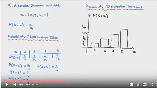

Forgive me I am a newbie of random variables. I saw a lot of course which introduce the Discrete Random Variables which always be illustrated with a histogram or bar chart . Like below
But in my understanding .I think it should be represented by a graph like below, all the probability value for the lowercase x {2,3,4,5} is point. not an area. (forgive me bad drawing).
My question is why it should be illustrated by a histogram or bar chart instead of point? Please correct me if there is something wrong . Thanks.

It is just a standard way to plot the distributions.
Theoretically, a point is more adequate to symbolize a single numerical value, e.g. P(x=2) = 2/14. Nonetheless, and despite not having an intrinsic value within themselves, it is visually easier and quicker to represent the values with bars.
    As the answer by BruceET shows, there is a point to using histograms (which represent probability by area): these have a direct connection with probability density functions, which also represent probability by area. Their use for discrete variables is not strictly necessary, but is an excellent conceptual and pedagogical tool for generalizing results and intuition about discrete variables to continuous variables. – whuber Jan 21 '19 at 18:25
