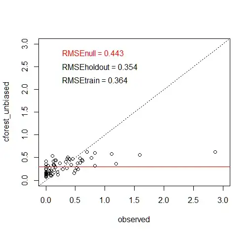

I've tuned the hyperparameters for each model and achieved the same cross-validation RMSE accuracy. However, only the random forest model gives a satisfactory fit for the training data. Below are the calibration plots and fit stats (the red, horizontal line in each is the observed mean corresponding to the null RMSE).
I have used predict() on the caret models and am confident that these are predictions are for the training set. Predictor variable importance statistics and partial dependence plots are qualitatively similar for all three models (except that cforest does more to reduce bias). So, while these three models detected similar patterns in the data, how come two of the three fit poorly to the training data? My choice was random forest, but I haven't found an effective method for correcting for bias in the importance statistics for that model.

  • What do you mean two out of the three fit poorly to the data? The last two have the same RMSEtrain of 0.364 which is still higher than the null model, with randomForest having the smallest error. Have you tried running the models a couple more times to check if you get similar results? – user2974951 Jan 18 '19 at 12:29
  • There's a gross difference in scatterplots and RMSE for the training data. My questions are how this occurs (considering that CV RMSEs are similar) and whether that's important? E.g. Leathwick et al. (2006) reported similar residual deviance for training and holdout data, but Oppel et al. (2012) reported calibration plots and results. Refs: Leathwick et al. (2006). Variation in ... fish species richness ... using boosted regression trees. Mar Ecol Prog Ser 321: 267-281. Oppel, S. et al. (2012). Comparison of five ... techniques to predict ... seabirds. Biol Cons 156: 94–104. – stweb Jan 19 '19 at 07:53

I don't know why randomForest has smaller RMSE on the training set, I would assume it's because RF by default builds deep trees with no pruning, hence why they may explain the training set a little better during building. However, in most cases this should not be a problem, it is hard to overfit a randomForest model, because of the many trees which will, on average, even things out. Cforest and gmb on the other hand have by default set limits on the depth of the trees and on-the-fly pruning, and this is why I think they have worse performance on the training set. Nonetheless, all models have very similar RMSE based on CV so they all perform equally well. Choosing a model now is just a matter of preference.

  • OK, this post, suggests that, for random forests in particular, performance on training set data is meaningless. It appears to me that calibration plots are only for 'explanatory modelling' (Shmueli 2010) where the theory is well defined and goodness of fit (i.e. to the training data) is informative. That random forests fit the training data better than other ML models is a trap. Ref: Shmueli, G. (2010). To explain or to predict?. Statistical Science, 25(3), 289-310. – stweb Jan 19 '19 at 22:43
  • @stweb So it is as I said, the randomForest package grows very deep trees, so they perform very well on training data (especially classification). Also as noted, this is true for almost any model and you should not rely on this measure, and you should use the OOB / CV approach for an estimate of error. – user2974951 Jan 20 '19 at 08:27
  • I have also found that I can make cforest fit the training data by reducing the parameters minsplit and minbucket. Sooner or later we might read a paper on 'Use and misuse of calibration plots' (in Ecology, at least). – stweb Jan 21 '19 at 12:19
  • @stweb I don't know specifically about gbm, but I know that boosting also allows for building deep trees, so it is not specifically isolated to the other 2 methods. I don't know about ecology, but in the machine learning / statistics world no one takes training error seriously, since it is known to be a poor performance metric (optimistic). You look only at CV error or a separate test set prediction error. – user2974951 Jan 21 '19 at 12:24
