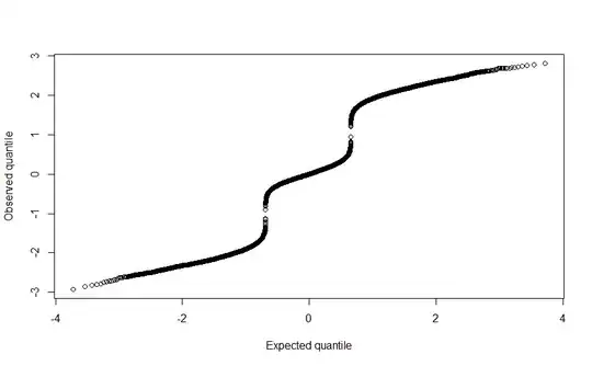

Here's a counterexample to your approach: mean = median = mode
If you sample from this distribution here is the QQ-plot:
And the Mean-squared displacement from the calibration line is:
set.seed(123)
n <- 1e6
p <- rbinom(n, 2, 0.5)
x <- numeric(n)
X <- cbind(rnorm(n, -2, 0.25), rnorm(n, 0, 0.25), rnorm(n, 2, 0.25))
for(i in 1:n) x[i] <- X[i, p[i]+1]
mean({sort(x) - qnorm(1:n/{n+1})}^2)
gives a stable constant that converges to a fixed, finite value as $n \rightarrow \infty$.
In this case: $\approx$ 0.32
