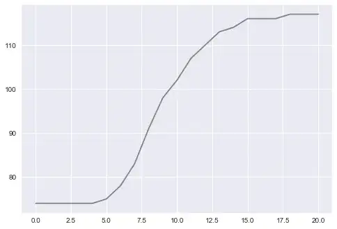

Is it possible to fit a quadratic or polynomial model with this type of data?
Two inputs, input one is a temperature sensor:
Input two is a valve opening on a scale from 0-100:
This is a scatter plot of the relationship between the two: enter image description here
Ultimately I am hoping to fit the data to a model about the relationship and then create some sort of a function (using Python) to create some simulated results..
Can someone give me a few tips on how to go about this maybe from a statistics standpoint? I understand regression but I have yet to venture onto logistic regression and beyond to fit data like this. (not a lot of wisdom here) Anything related to a Python package would be helpful too.

It looks like you're plotting the opening of a valve over time. As the valve opens, the temperature of something (a fluid in the valve?) increases.
Given that you data follows an s-curve with two bends, I would model the process using a third-order polynomial.

Graph of results below. Plot
Alternatively, you can get a better fit with a spline regression. A spline is a smooth function built out of smaller, component functions.

By limiting the boundary for the knots within the interval that the valve openness affects the temperature, I basically eliminated the over-shooting of the previous polynomial model. Then I put in the knots in the IQR for the data (not adjusted for the bounds).
Spline Model
Note that the model can still extrapolate outside of the bounds, but the model fits the data (given the assumptions) much more closely.
  • Wow thanks. Yes it is a hot water valve in an HVAC ducting application and the sensor is reading the air after the hot water coil. What computing language are you using? I’ll have to do some research for this type of model in python. – bbartling Jan 10 '19 at 01:10
  • As hinted by the poor fit, especially in the upper right, a polynomial model is a particularly poor choice for these data. The OP would be better served by explaining that and proposing a more suitable one, rather than leading them down a misleading avenue of investigation. – whuber Jan 10 '19 at 17:16
  • Henry, the code is written in R. It just a linear regression of the form temp ~ valve + valve^2 + valve ^3. @whuber, I'm not sure what other model would work better. I acknowledge that by definition the model is going to over-estimate at the bounds given the structure of the function. It is an s-type curve so a third order polynomial creates that shape. I'm not aware of another model that can create an s-shaped curve while remaining flat on the lower and upper bounds. – Blake Shurtz Jan 10 '19 at 18:44
  • A cubic polynomial does not have the requisite properties of rising from a minimum to a maximum, which (as a reasonable guess) this one must. Physical theory will suggest an appropriate form. Absent theory, if the objective merely is to fit a smooth curve to points, then a spline will do nicely. – whuber Jan 10 '19 at 18:50
  • Here is an article about spline regression in python https://www.analyticsvidhya.com/blog/2018/03/introduction-regression-splines-python-codes/ – seanv507 Jan 11 '19 at 07:19
  • Thanks for the tips, is ridge regression another option of fitting data like this to a model? – bbartling Jan 12 '19 at 19:58
