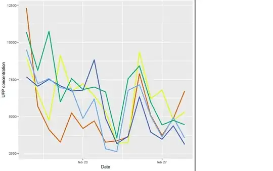

I have several data sets with air quality measurements for 20 locations. The measurements were done per second over a period of two weeks, 5 locations per period (because there were only 5 instruments).
The data looks stationary when plotted (see plot for 1 period). I want to calculate the cross-correlation between the relevant time series, to see if there is a temporal correlation between the measured concentrations at the various sites. enter image description here
It does not feel useful to analyze the data per second. What is the best way to go with this? I tried to use hourly average. Or should I smooth the data? I read something about modeling the data (How to use Pearson correlation correctly with time series), but that sounds rather complicated.

  • If you want to calculate the cross-correlation between the relevant time series why do you not feel [it is] useful to analyze the data per second? – Benjamin Christoffersen Jan 05 '19 at 10:27
    Because when measuring air pollutants (in this case ultrafine particles) the measurements tend to have a lot of irrelevant peaks which are considered artefacts, whereas the mean/moving average over a longer period is considered a good representative of the actual measurements. I guess I just kind of answered my own question? :) – Qeshet Jan 05 '19 at 19:34
