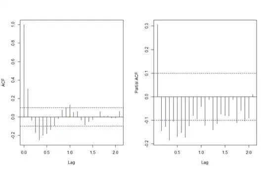

par(mfrow=c(1,2))
acf(model$residuals,main="")
acf(model$residuals,type="p",main="")
ACF and PACF of the first regression model, clear seasonality
ACF and PACF of the first regression model, clear seasonality, so I used stl to remove the seasonal and trend components

According to the assignment, I am supposed to move on to the pre-whitening stage after this step in order to determine the number of lags I should incorporate into the model, but the data is clearly not ready for this stage yet since there are some many significantly correlated lags still apparent in the data. Also, when I tried to iterate the number of lags within the arima model (for the pre-whitening), the AIC kept improving well past the orders of 8 and 9, but I have been told that the AIC should normally decrease until it reaches a sort of plateau, after which AIC values should again increase, thus making a clear choice of which order is most suitable.
