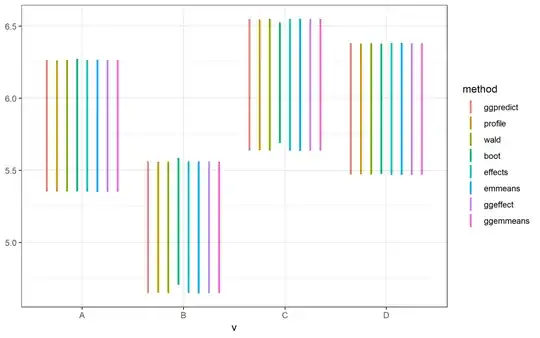

Confidence Intervals for Marginal Means
The confidence intervals produced by the effects package are substantially smaller than others. I noticed someone asked a similar question before, but its answers showed that CIs produced byeffects are very similar to others. I wonder what's going on here. Did I miss something?

After upgrading to the latest versions, however, all methods produced similar CIs.

    Good to know where this error comes from. The smaller CI for ggeffects 0.7.0 in your example seem plausible (and would also have occured with ggeffects 0.8.0), because the ggeffect() function simply wraps effect() - and if the source of this "bug" was the older version 4.0.1 of the effect-package, ggeffect() will also have this "bug". – Daniel Jan 10 '19 at 20:24
I have just checked your example (using the just released version 0.8.0 of ggeffects), however, instead of using effect() or emmeans() directly, I use the functions from ggeffects, which actually wrap around these functions (ggeffect() and ggemmeans()).
## effect
c4 <- ggeffect(fit, terms = term)
c4 <- c4[,4:5]
## emmeans,'kenward-roger'
c5 <- ggemmeans(fit, terms = term)
c5 <- c5[,4:5]
Here, the CI's are similar.
Also, after exactly running your examples, the plot is identical, with no deviation for effects.
