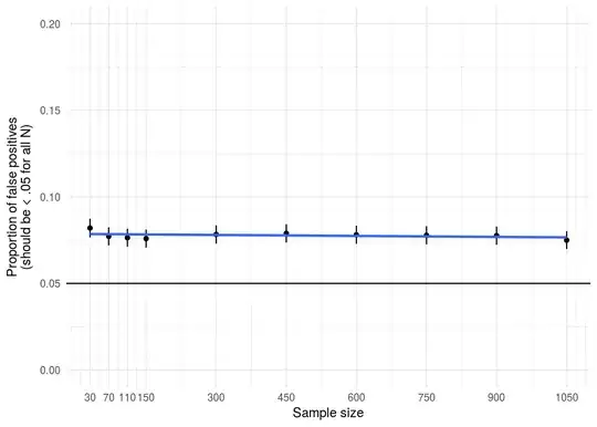

If I use an AR(1) structure for the residuals, I see positive bias (and as a result, poor error control).

This shows no bias, but bad error control.
What's going on?
I imagine that I've simply taken a wrong turn somewhere, but I'm not sure where. It sounds like it's a bad idea to use lagged DVs in your model, but for my toy example this doesn't seem like a problem (until I use within-person centering). The AR(1) fails in both the within-person decomposition and non-decomposed cases (more detail here: https://jflournoy.github.io/lagged_mlm/ar_stuff.html).

  2. Why are the significance tests of the effect of the within-person-centered IV $x^\text{wi}_{t-1}$ anti-conservative?
