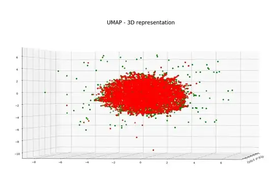

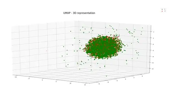

I have a dataset associated with labels. According to https://arxiv.org/pdf/1802.03426.pdf --> UMAP (Uniform Manifold Approximation and Projection) which is a novel manifold learning technique for dimension reduction and the data, I succeeded to create the green and red clouds bellow. The problem I have is they are stick together. For machine learning purposes, it is kinda hard to learn something when the clouds are placed that way.
Cloud 1
Cloud 2

I have already used several approaches to tackle my problem, i.e. PCA, t-SNE, SVM, using a neural network to classify the points. The problem is I got always two clouds but stick together. UMAP gave me the best results. Now, once UMAP has been applied, I want a way to force the clouds to be separated in knowing the clouds are already well distinct.

Even shuffling the data gave me the same plot result

    Are you sure that the apparent separation of red and green isn't an artifact of the way that you plotted the data? If the data is sorted by red and green, plotting libraries will sometimes plot the data in order, so you can get plots that appear to show that the two are distinct when in fact one is right atop the other and there's no distinction between them. Shuffling the data and plotting the points with some transparency can help this. – Sycorax Dec 10 '18 at 16:09
  • @Sycorax I updated the question – davegaut Dec 10 '18 at 20:52
