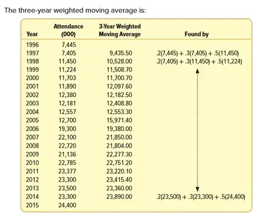

  1. Calculation of weighted moving average enter image description here

  • Nick, just another question about weights as you brought them up, I added a screenshot to the original thread. Why do they apply weights in this way? For me, it would make sense to weight up all recent periods with a higher weight than the earlier periods. Why do they use a weighted moving average like that? The task was to ' Compute a three-year moving average and a three-year weighted moving average with weights of 0.2, 0.3, and 0.5 for successive years.' Does it make sense to calculate it with weights for successive years? – Ekaterina Ponkratova Dec 01 '18 at 11:39
  • I guess it depends 'on how you think of your moving averages'. And again, we got to the use case. – Ekaterina Ponkratova Dec 01 '18 at 11:55
  • Again, you're referring to an anonymous text I don't know. If the authors don't explain well, perhaps you need a better text. Different weights can make sense. I don't know a specific justification for 0.2 0.3 0.5 beyond some judgement possibly based on experience. Exponentially weighted moving averages make the notion more systematic. I doubt that you need to write any new code. Python must have functionality for translating vectors so that you copy leading or lagging values of existing vectors, but -- sorry -- I have never used Python and questions on coding issues are off-topic here. – Nick Cox Dec 02 '18 at 09:05
