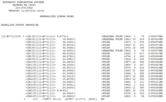

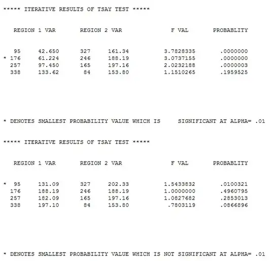

You say "log-difference to get a stationary process" . One doesn't take logs to make the series stationary When (and why) should you take the log of a distribution (of numbers)? , one takes logs when the expected value of a model is proportional to the error variance. Note that this is not the variance of the original series ..although some textbooks and statisticians make this mistake.
It is true that there appears to be "larger variablilty" at higher levels BUT it is more true that the error variance of a useful model changes deterministically at two points in time . Following http://docplayer.net/12080848-Outliers-level-shifts-and-variance-changes-in-time-series.html we find that enter image description here
The final useful model accounting for a needed difference and a needed Weighted Estimation (via the identified break points in error ) and ARMA structure and adjustments made for anomalous data points is here .enter image description here
Also note that while seasonal arima structure can be useful (as in this case ) possibilities exist for certain months of the year to have assignable cause i.e. fixed effects. This is true in this case as months (1,6 and 10) have significant deterministic impacts ... Jan & June are higher while October is significantly lower.
